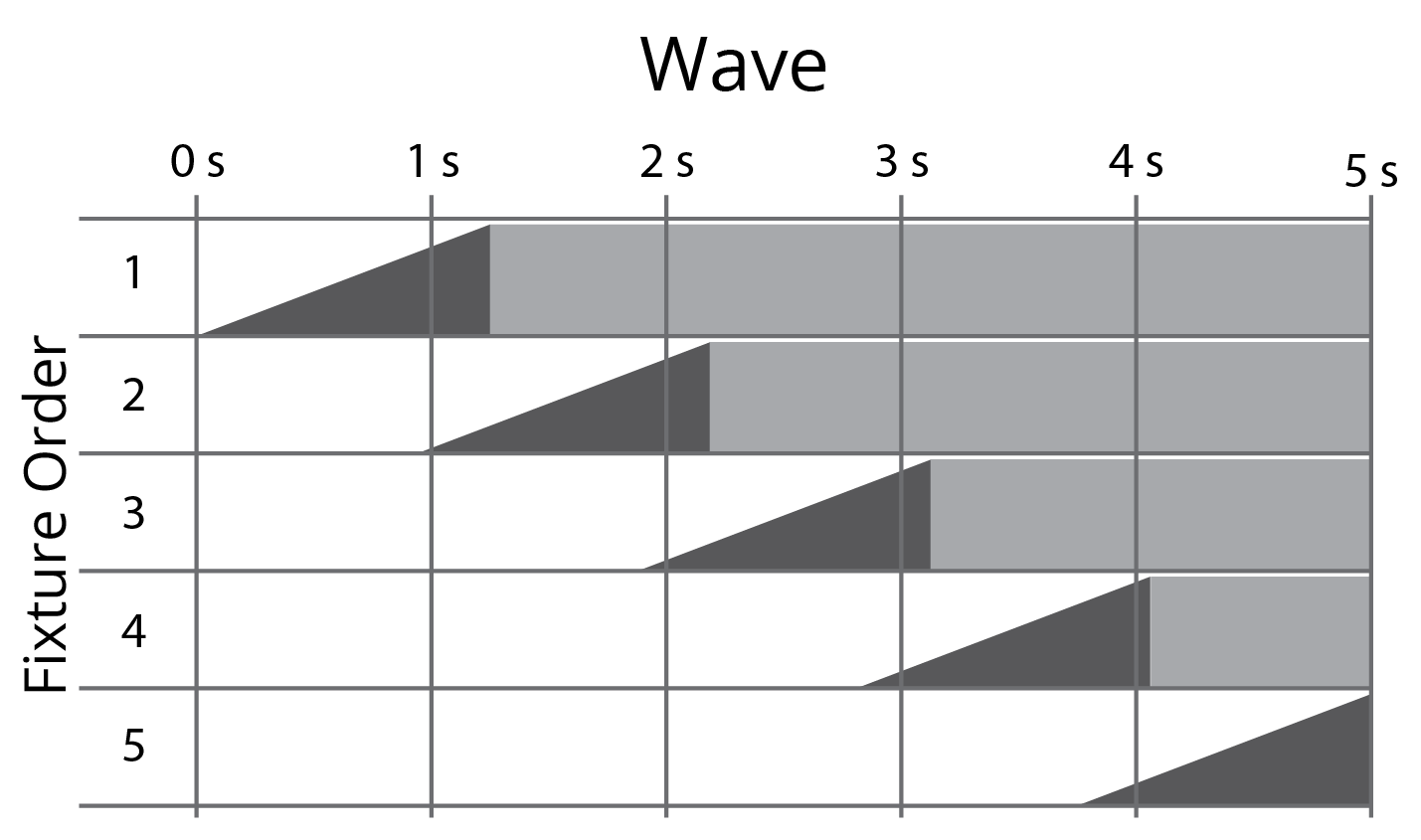

Wave, Staggered, Spread, and Multispeed
These 4 Skew types propagate through a list of grouped fixtures at varying rates thereby producing different fade-in effect across the affected fixtures. The visual difference between each Skew relates to how many of the fixtures in the group are actively fading-in at the same time as well as at what rate.
The effects of each Skew are best demonstrated by the below graphic showing the 4 Skews applied to a 10s fade-in effect.
                Below is a more technical overview for each Skew covering what is happening to each fixture's fade within the affected group.
NOTE: With these transitions we highly recommend experimenting using Simulate as the results can often be surprising. The Skew feature is also greatly enhanced when paired with the Direction.
For Wave, the fade-in time for all fixtures within the affected group is equal to a quarter of the set total fade time. This will typically produce an effect similar to a wipe transition with a narrow band of fixtures that change at the same time.
                For Spread, the fade-in time for all fixtures within the affect group is equal to half the set total fade time. This, like wave, also produces an effect similar to a wipe transition, but with a broader band of fixtures that are changing at the same time (compared to Wave).
                For Staggered, each fixture will start fading in turn - but they will have different fade times so that they all finish fading together. This will produce an effect that will start as a more gradual transition that appears to accelerate towards the end.
                For Multispeed, all the fixtures will start fading at the same time, but fixtures at the top of the group will complete the fade more slowly than the fixtures at the end of the group (see figure below). So it will start as a rapid transition that appears to slow and linger towards the end.
